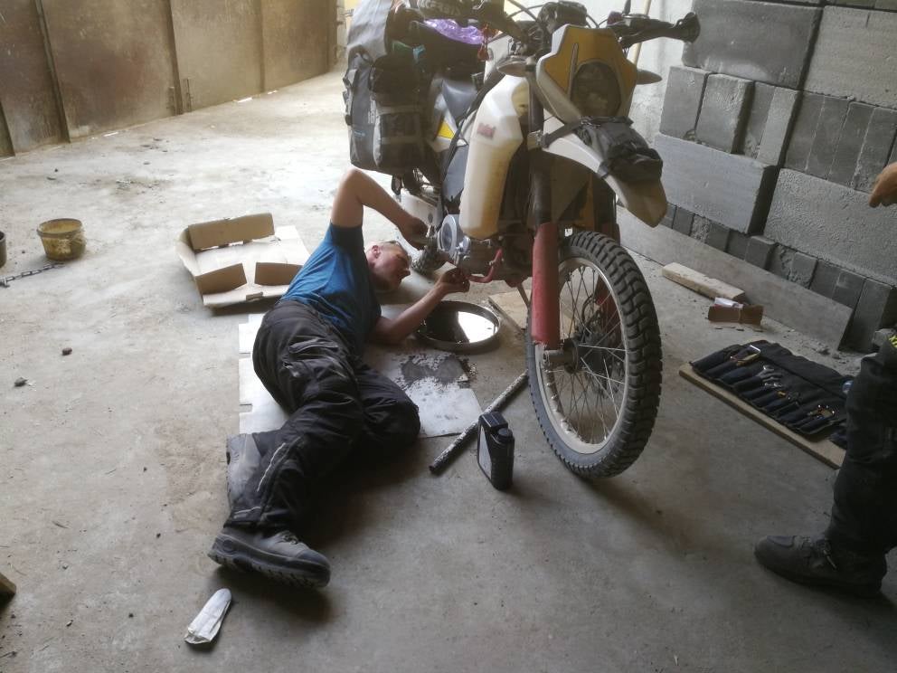

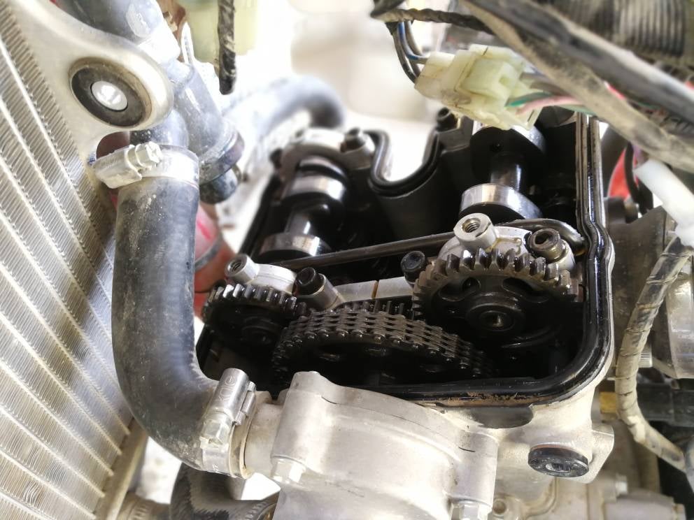

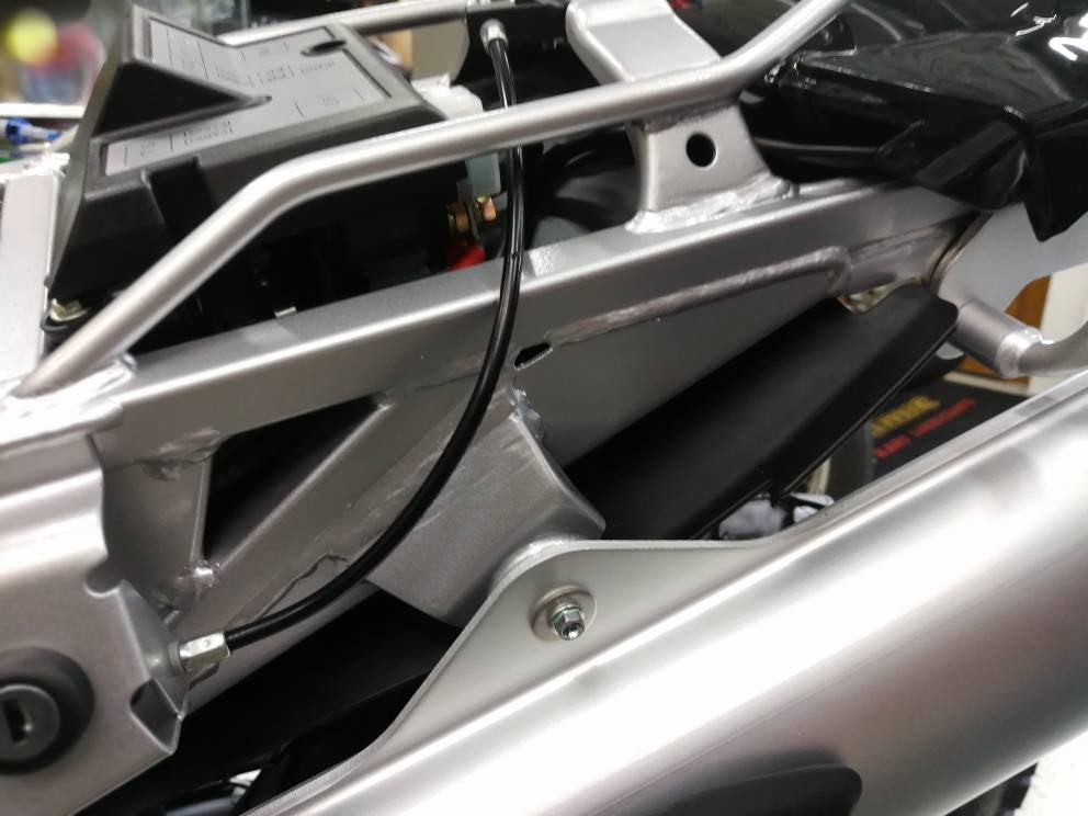

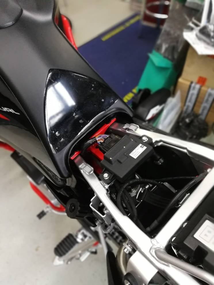

    To tell you the truth - I believe that this too was a failure on my behalf! :-/ no warranty here to be fair.
    I unknowingly fitted the hose clamp bolt in the wrong position. This in time with constant vibrations from the conditions of the tracks rubbed against the radiator and pssssss....!
    Now I know better - lernt from my mistakes.
    In the picture where we were replacing the camshaft bearing - if you look at the hose clamp you can see where the bolt head was already rubbing. If only we knew then that this would give us more memories a week later... :-D[​IMG]

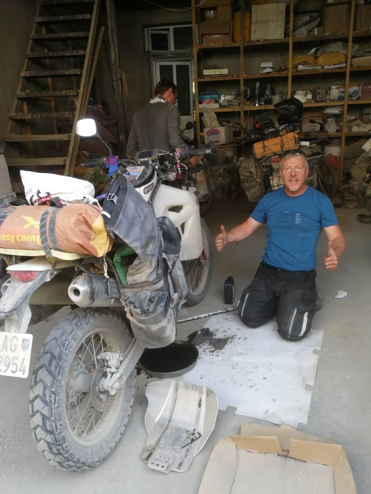

    No ride report just yet - too busy planning for the next trip mid January to the south side of the Atlas mountains in Morocco, Africa.
    Yes we did the Pamir - results were the sheered subframe bolts... But I would HIGHLY RECOMMEND doing the Bartang valley instead. (but you do need 400+km of fuel capacity - and it's hard conditions)

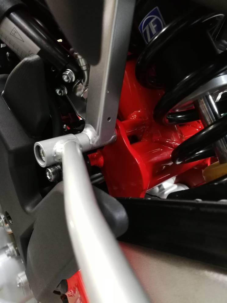

    Regarding subframe and whatnot. I've actually ordered the SD steel subframe and will exchange it. You have extra support plates and double rear rack! Photo below of SD subframe details [​IMG][​IMG][​IMG][​IMG]

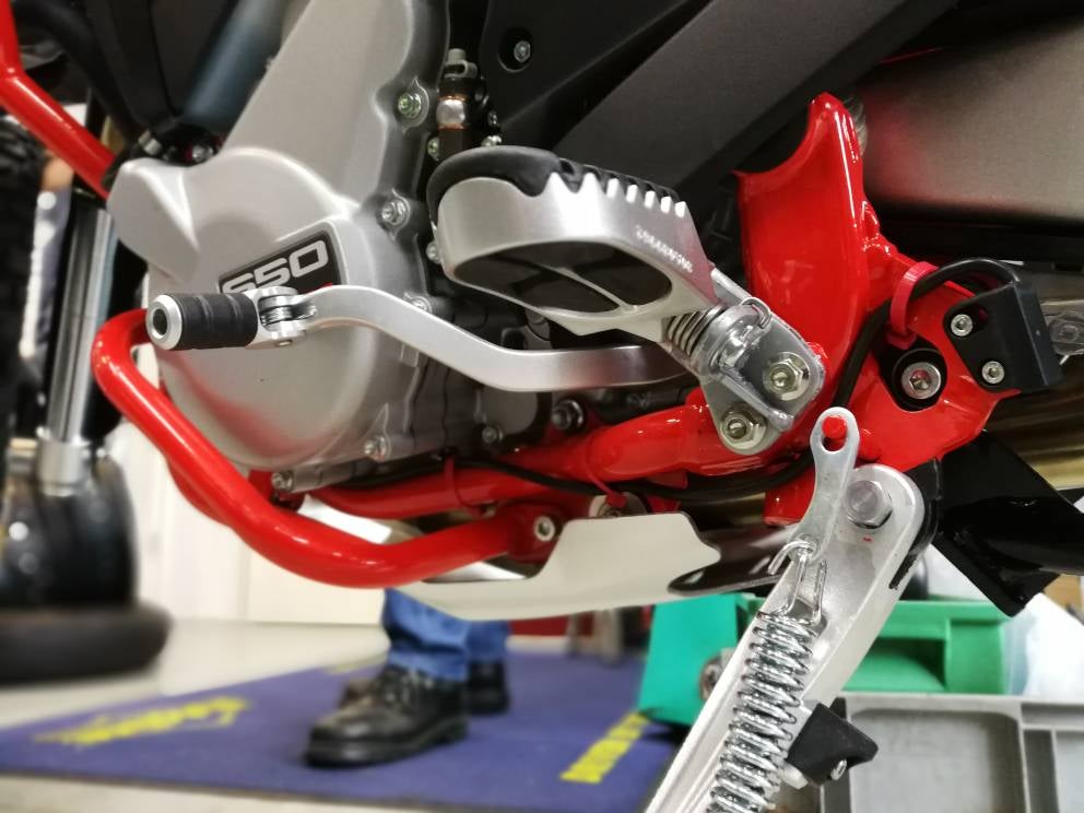

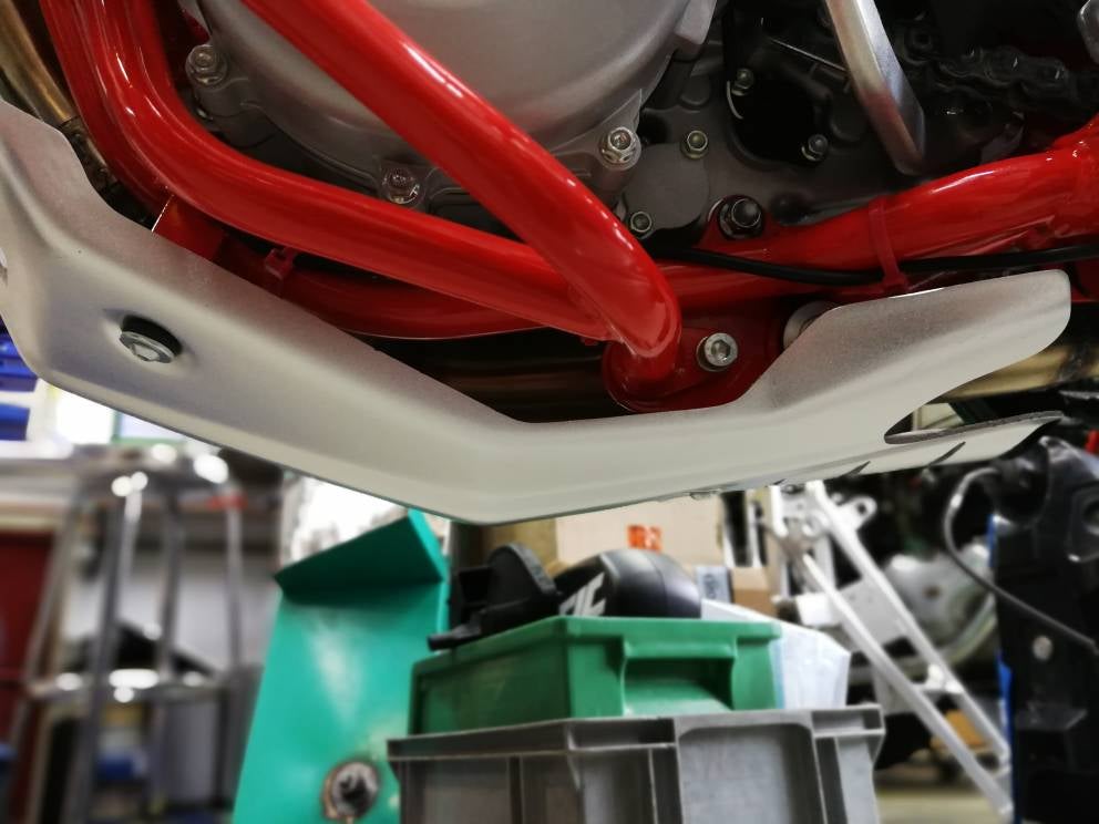

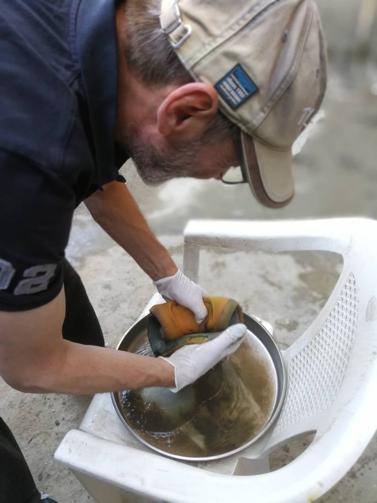

    We changed the oil and main filter after every 2500 km. Now don't go thinking that this becomes expensive - 'cos it's not!
    OIL FILTER
    Here in Switzerland for the RS is around 10 SFR vs Triumphs 75 SFR.
    Sure the Tiger has a longer service intervals - but if you calculate that the Tiger is 7 x more expensive then: for the price of 1 Triumph filter you're going to do 17500km at a 2500 change intervals on the SWM!
    OIL
    There's only 1.8 ltr in the RS.
    Changing is easypeasy... Honestly.
    And the air filter is soooooo easy to get too!
    Far unlike the Tiger... What a F nightmare!
    [​IMG][​IMG][​IMG]
