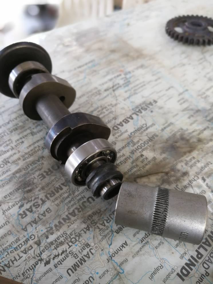

    We went down to the local Bazar and found one that was similar (same outer diameter and inner race) - but obviously you don't have many SWM dealers on the PAMIR highway...
    You have to work with what you get.
    The unfortunate thing is that the bearing was the one one the cog/sprocket/drive side!
    Twoz a challenge to heat the thing up to remove.... [​IMG][​IMG][​IMG]
    The replacement bearing was different in the fact the the ball bearings were a little small! Not so heavy duty as the OEM ones installed.
    But it did the job to get us home.
    The cam is being replaced on guarantee now.

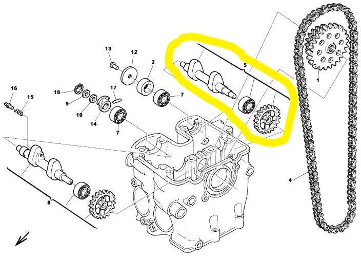

    Exactly - they are replacing the cam with the pre-installed bearing and sprocket.
    As seen in the parts illustration - you can only order part 5 - complete. [​IMG]

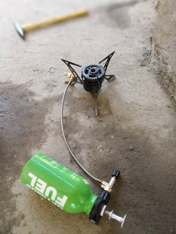

    was it difficult to remove the timing gear? I saw from the pictures you used a stove. Is the gear secured with a locking pin?

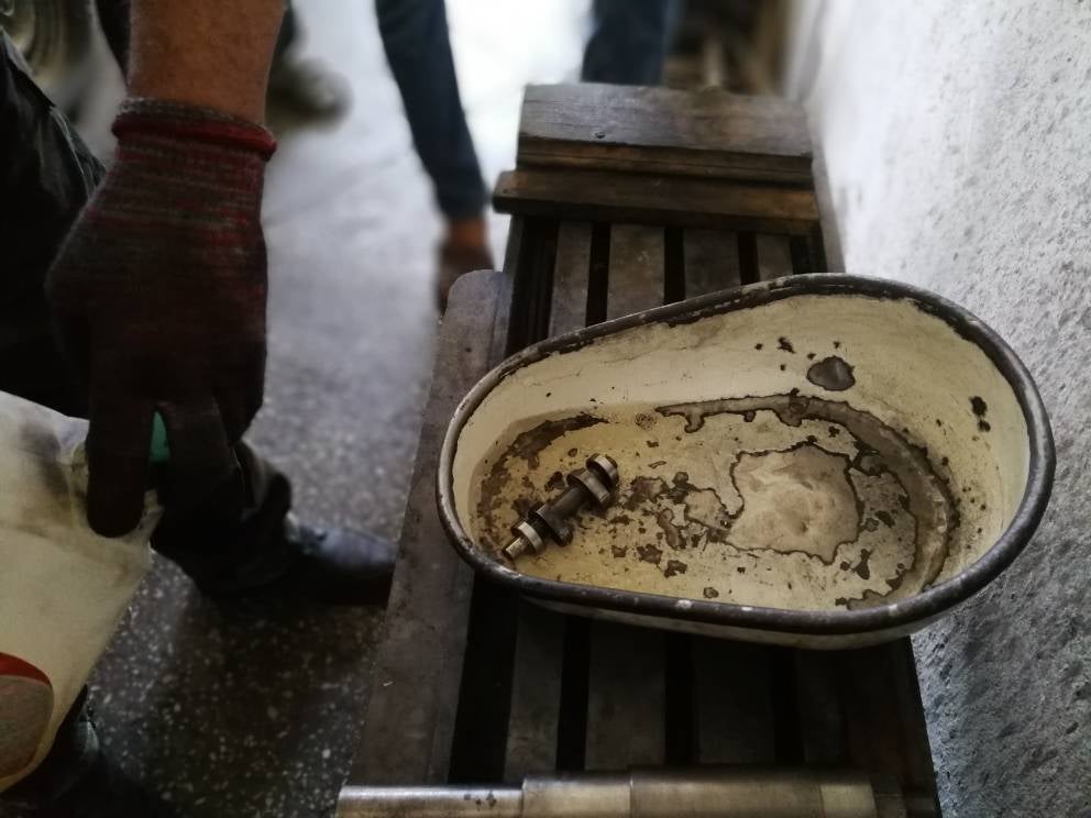

    VERY VERY VERY difficult!
    And also EXTREMELY risky because the geared sprocket is casted and rather thin. Too much force and then it's a clear "GAME OVER"...
    No locking pin, it's simply pressed on!
    I had one guy pull the gear and bearing off - but it looked like a butchers job afterwards... So I didn't go back to him to put it back together.
    I thought I would try myself (photo of cooking stove heating up) - but I didn't manage to press the gear on fully and couldn't get it back off either!
    I was stuck.... :-/
    So I had no other option than go to a local 'expert' who I was initially advised to go to!
    This guy is a hugh toothless Russian working in a backstreet garage in Osh, Kyrgyzstan - and not able to speak a word of English!
    I honestly had a bad feeling at first - but as my friend said - these guys really are experts working in these conditions. They have nothing else and work with what they have - constantly fixing things that we here in Europe would have long since thrown away!
    The guy was brilliant - put the half assembled part in his hand and woooosh, he was in his element and fixed it perfectly!
    Pressed on, washed, dried and re-greased...
    And he didn't want any money for the work!
    [​IMG][​IMG][​IMG][​IMG]
