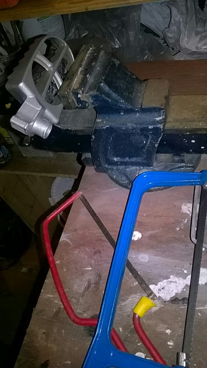

    Work in progress [​IMG][​IMG]
    Inviato dal mio GT-I9060I utilizzando Tapatalk

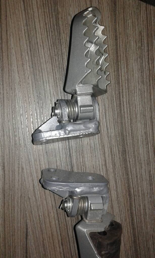

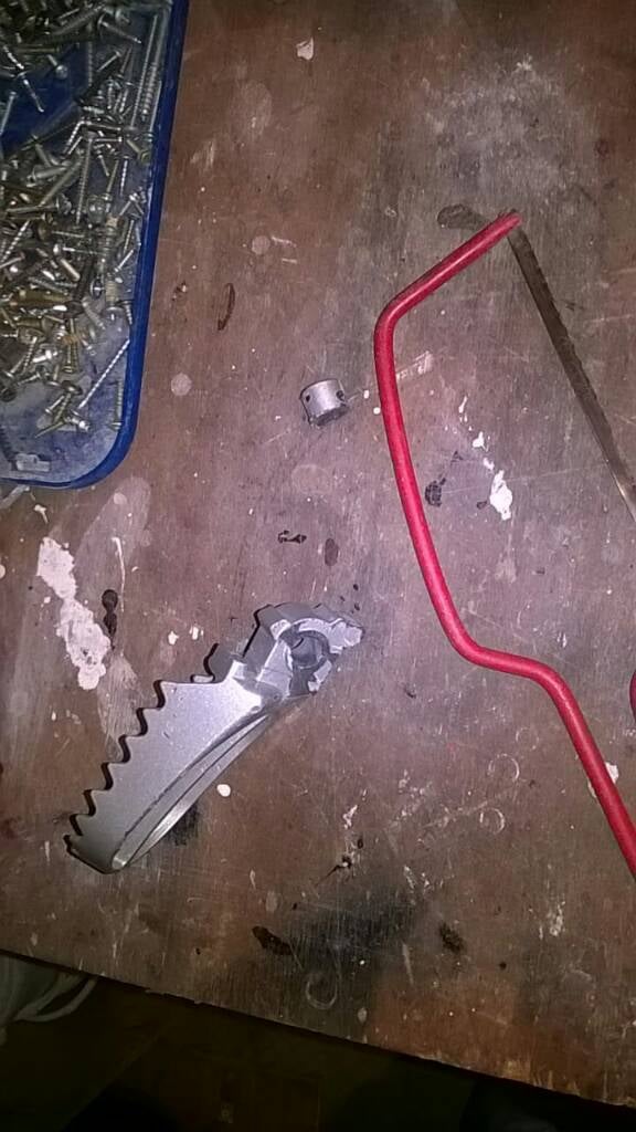

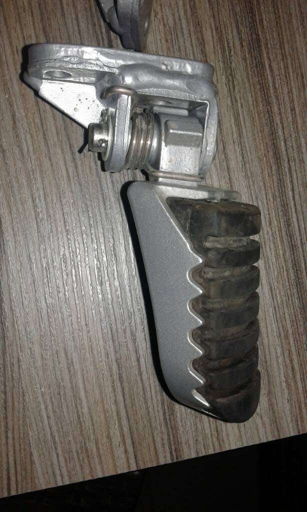

    modification of the platforms made by cutting a piece with a small manual saw[​IMG][​IMG][​IMG]

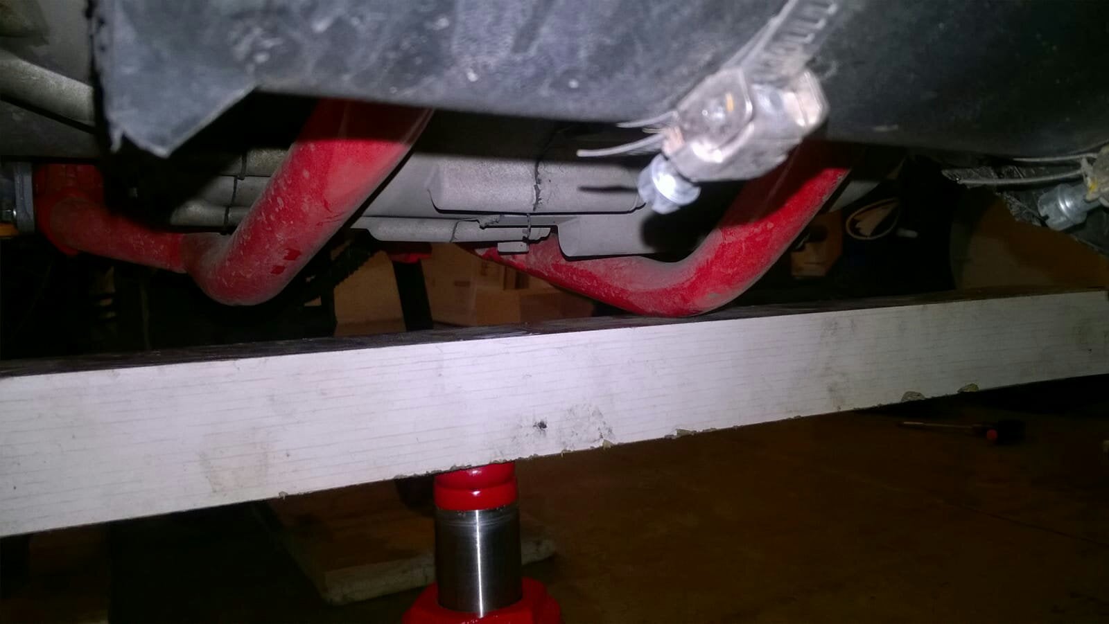

    can anyone tell me where to buy a motor protector for RS650R? With Nicola we realized that the frame tubes are not at the same height and this could cause problems with an unsuitable motor protector...[​IMG]

    I put a b and b bashplate on my RS650. Didn't notice the uneven framerails. Will check next oil change.
    Rotax655 likes this.

    I would do search for TE630 and check the comments on forums etc... There should be enough ppl who tried what brand/model.
    I would prefer carbon fiber or hard plastic types with letting easy oil change... Metal or Allu ones reflecting engine sound and increasing noice noticeably they say... Carbon/plastic s are more absorbing I guess
    And if you really gonna cross over some woods or trees alluminum edges may not provide smooth enough surface .
