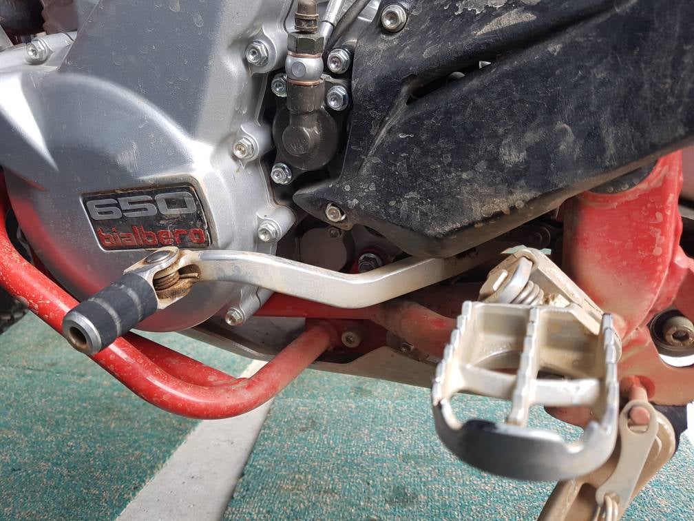

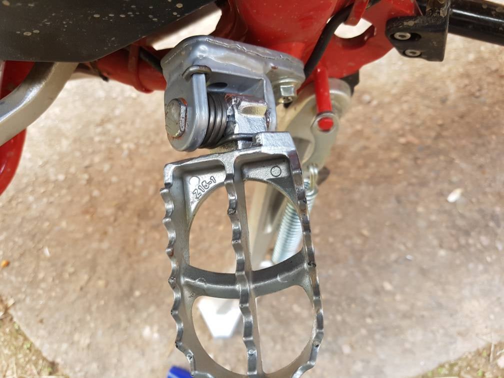

    Gear lever off the SD is a longer alloy jobbie, and chop and swap the footpeg lugs to get them lower and further back.[​IMG]

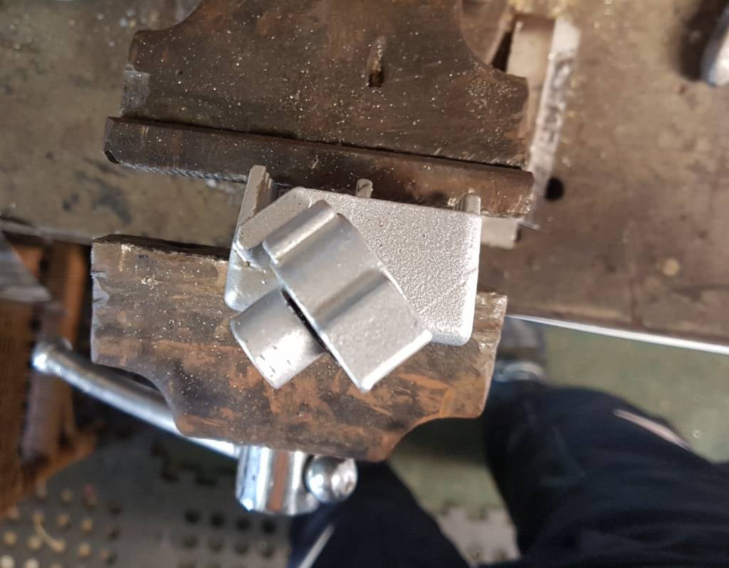

    Just cut off lug (spacer bit) where spring sits and put it on other side. I just tack welded in a few spots. Its a common Husky mod, a lot dont seem to worry about welding it back on, they just let it sit on other side.[​IMG]

    A better shot of the SD gear lever. (Sorry about the dirt, just got back from another epic ride!)[​IMG][​IMG]
