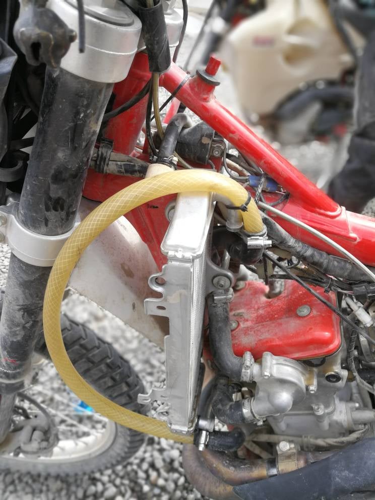

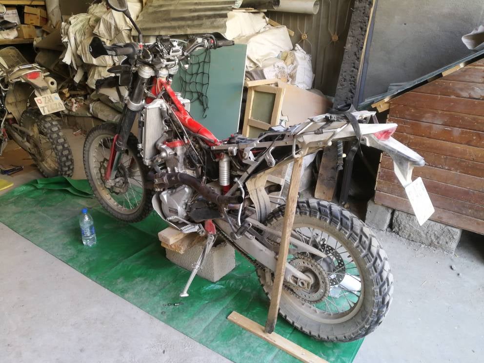

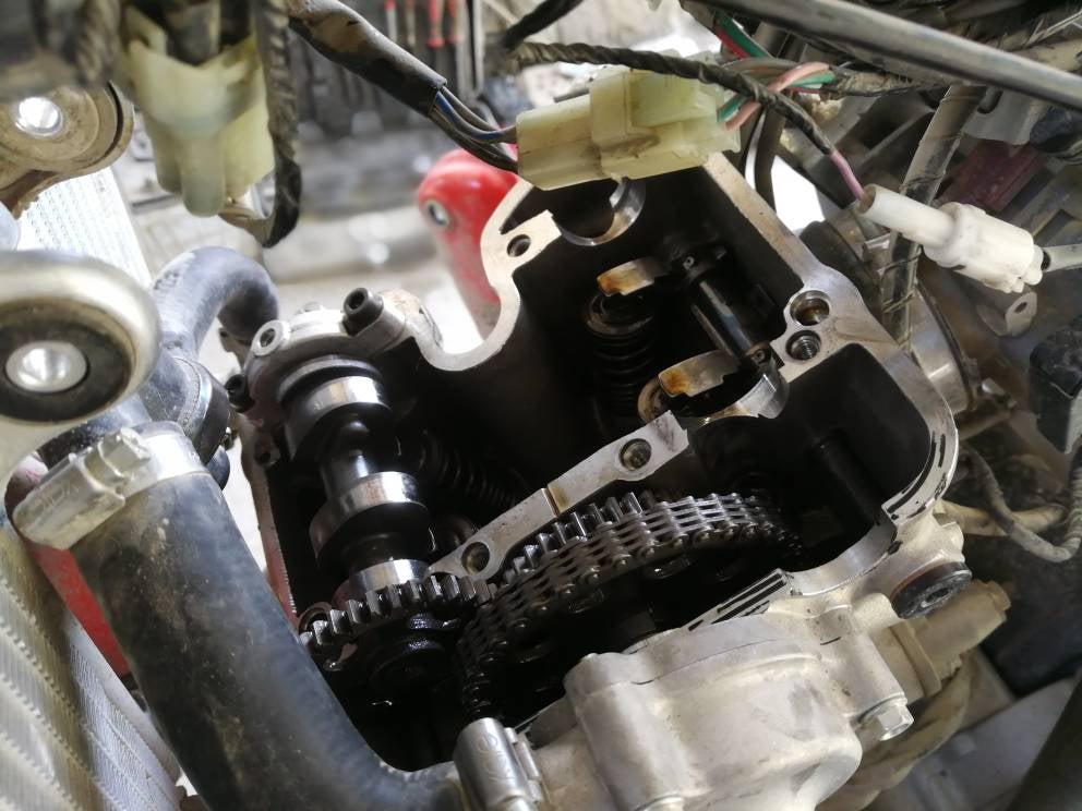

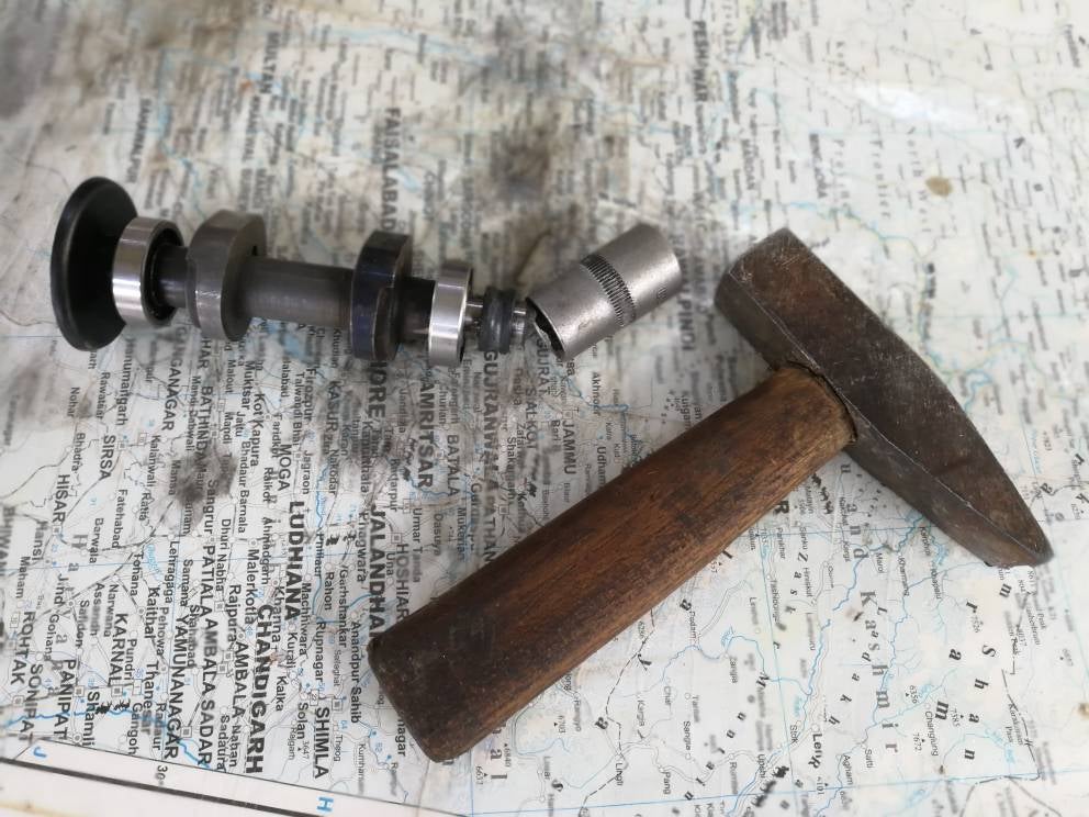

    Both my friend and I have been with the RS650R for a little more than a year now. And wouldn't give it up for any other model out there!
    No real problems as such, but did experience some unfortunate issues on our last ADV trip:
    - rear frame bolts sheered
    - leaking radiator half
    - camshaft bearing
    My friend had nothing!
    Sheered bolts were my fault for not checking more often. It actually stemmed from the main upper bolt being loose and that then allowed the vibrations to transfer to the smaller M8 lower bolts. They were removed and replacement bolts fitted.
    Radiator is just one of those things when a stone has its way. We did a roadside reparation by bridged half the radiator with a hose tube until we found a dealer (back home).
    Camshaft bearing... Well this is one of those 1 in a million. We could repair it along the way with the help of many around - and in doing so have great stories.
    Now considering the fact that the trip was over 5000 km with 80% off road - 20% extremely hard goings, I'm very happy with the bike.
