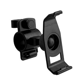

  18. airhead_irl
    airhead_irl Airhead addict
    Joined:
    Jan 20, 2010
    Oddometer:
    665
    Location:
    Eire (Ireland)
    I recently bought one of these handlebar mounts for my Nuvi 250:
    [​IMG] [​IMG]
    For power, I was going to buy the Garmin hardwire pigtail harness but then I had a "eureka moment" á la McGuiver and decided to modify my Garmin car
    charging cable/connector. I spied an older broken trickle charger that I had in my garage so with my creative hat on, I cut the Garmin charger open......
    [​IMG]
    [​IMG]
    I de-soldered the red and black wires and replaced them with the connector from my old trickle charger (taking note of polarity here kids !). Here it is below
    going to the connector from the bike's battery......
    [​IMG]
    The final step was to cover it up somehow so I chopped up/shortened the original Garmin holder, bonded it back together with a two-pack adhesive and then
    sealed the open end with some silicone sealant to keep the evil watery stuff out.
    [​IMG]
    Et voilá - instant Nuvi power !
    #38

  19. Yinzer Moto
    Yinzer Moto Long timer Supporter
    Joined:
    Jun 13, 2008
    Oddometer:
    33,736
    Location:
    Pittsburgh PA
    I too have cut the cigarette ends open but never came up with a solution I liked. Yours looks clean. I buy the moto hard wire adaptors from eBay for about $15.
    I would suggest adding some type of rubber band to hold the garmin plug in the Nuvi if you do rougher road riding.
    I use something similar to this: http://www.twistedthrottle.com/ram-...3Y9gvWfGFDRh03YzCcBpRTV3_IJ0OBfkqcaAih88P8HAQ
    #39

  20. airhead_irl
    Joined:
    Jan 20, 2010
    Oddometer:
    665
    Location:
    Eire (Ireland)
    Yeah, I was aware that maybe I should reinforce how the plug goes into the back of the Nuvi. I guess vibration could/will kill it at some stage (riding
    a vibey ol' airhead and all :D). Even though it's mounted on a GS, I'm merely a wimpy tarmac rider so it might last a little longer !!
    By the way, thanks for that link - that looks like a useful piece to hold the cable tightly fitted.
