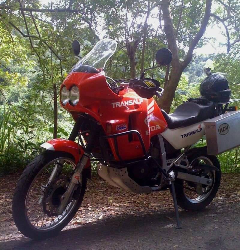

    One thin I will tell you: no bike is perfect! Having owned a 1998 TA I will say that if I have a chance to buy another, I would. Its a simple easy to work on and without all the electronics that need a rocket scientist to work with.
    CDI issues fixed. On long trips carry one. Then you can build something like I did...[​IMG][​IMG][​IMG][​IMG][​IMG][​IMG][​IMG][​IMG][​IMG]

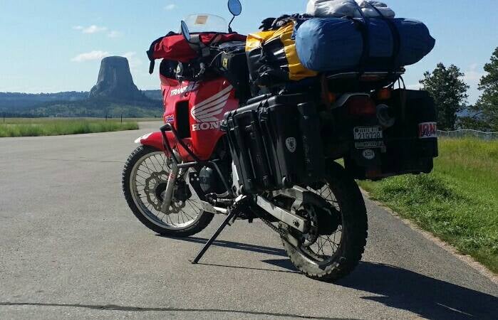

    Great non-sense bike. I got it now for 10 years and still going strong. Succes with yours !!
