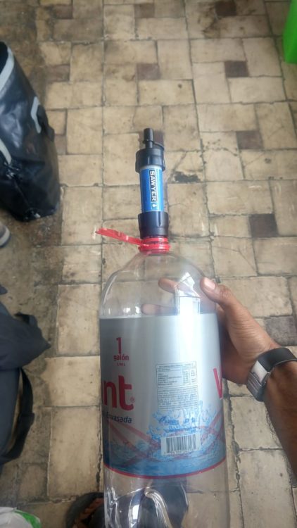

Rig it up to anything!
The Sawyer Mini has a 28mm female thread which allows you to fit any standard coke and pepsi bottle onto it.. you can also use this as a gravity feed system. And an inline filter(I wouldn’t run it as an inline filter for a hydration bladder).
