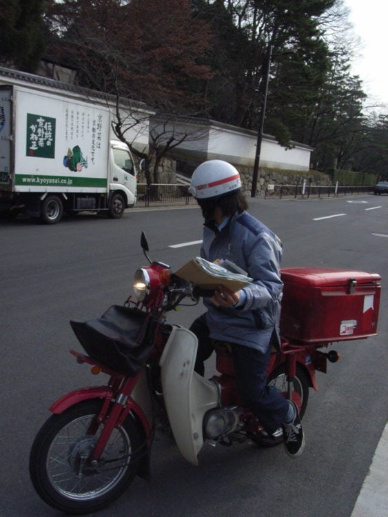

A Japanese postie bike, based on the Australian design. I don’t like that front carrier!

Another look at the Japanese postie bike in use. That does not look balanced front to back, to me.

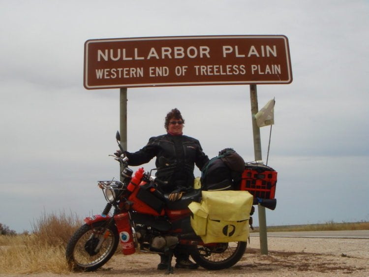

That’s Jacqui Kennedy who has ridden well over 50,000km on her second-hand ‘postie’, raising money for charities. Overloaded? I look the other way…
