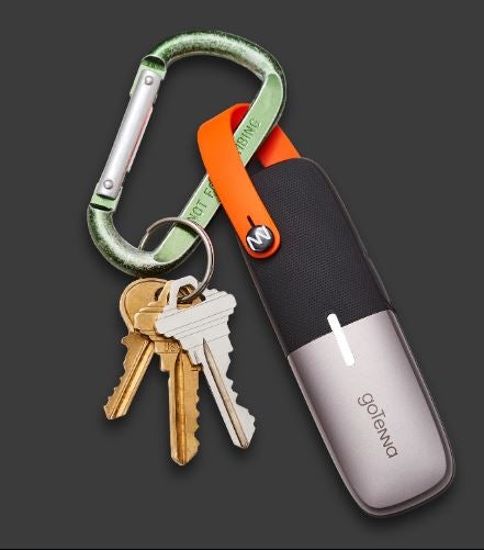

goTenna keys
The goTenna device is small. It’s not much larger than the keys on your keychain. Photo credit: goTenna

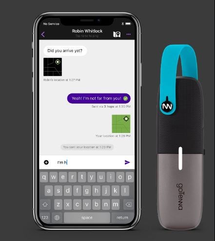

goTenna bluetooth phone
goTenna connects to your phone via Bluetooth allowing you to text and receive GPS location maps on your phone. Photo credit: goTenna
