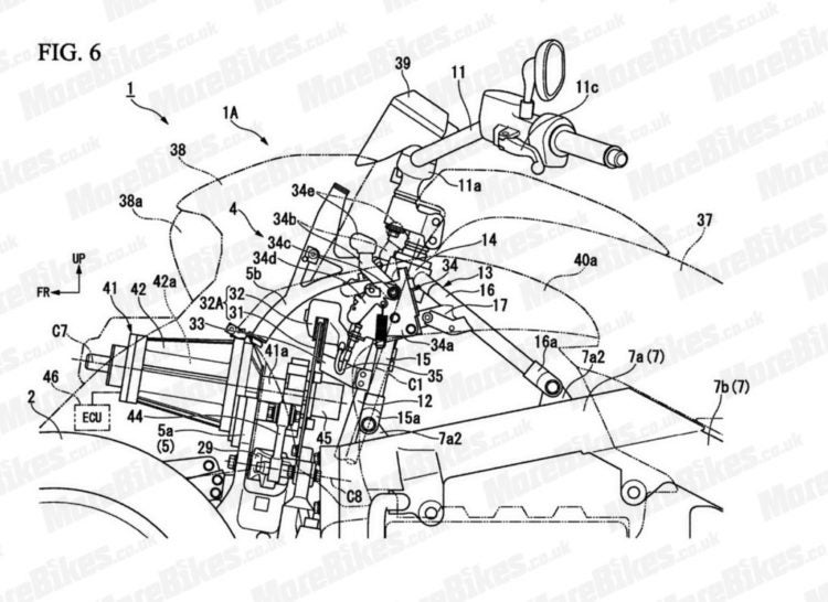

But in its latest patent filing, Honda has changed things up a bit.  From the patent drawings, it’s clear that this is a completely different unit.  Much smaller and more compact, the new unit sits squarely in the center of the fork assembly (Item C20 in the drawing).
Honda steering assist
A new smaller steering assist mechanism can be seen as item C20 in this patent drawing. Photo credit: MoreBikes.

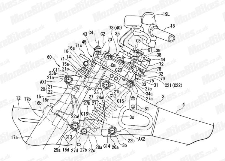

The power steering unit for the NEO Wing is a large bulbous protrusion way out in front of the fork and looks to be many times larger.
Honda NEO Wing steering assist.
It’s easy to see that the power assist mechanism for the Honda NEO Wing is a completely different design. Photo credit: MoreBikes
In the new patent, Honda registered and filed what it called steering assist.  Verbatim from Honda’s filing:
“An assist motor generates a steering assist force that assists a steering force transmitted to the steering shaft, and a sterring assist force transmit member is turnably supported by the steering stem.”
That’s not the clearest description, but it does indeed tell us that Honda wants to patent a system which will provide additional force into the steering mechanism.
