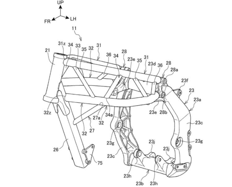

Honda Patent - Trellis Frame
The trellis frame version.
With a combination of aluminum castings for the swingarm pivot areas, and tubular steel for the forward section encompassing the headstock, the trellis framed version of the proposed street bike emphasizes stiffness and light weight, and would presumably be the sportier and costlier of the two frame options. An abbreviated down tube captures the front of the engine, which is a stressed member of the overall frame structure.

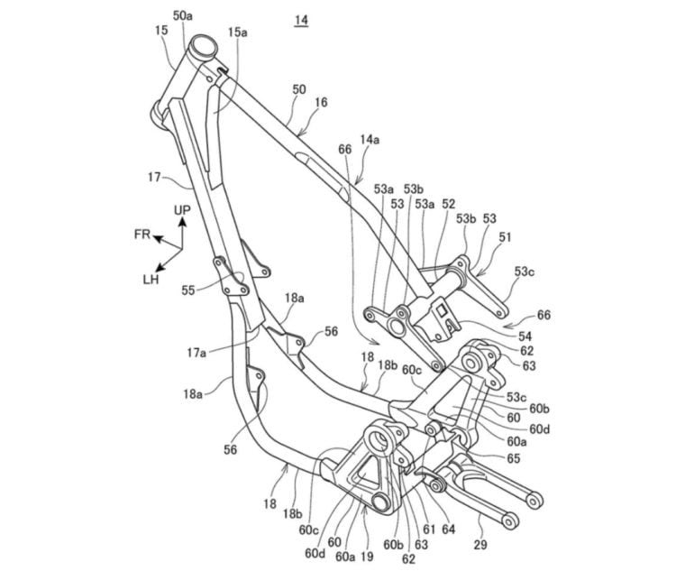

The cradle version of Honda’s patent.
The much simpler cradle-style framed version features a unique twist, whereby the rear upper portion of the frame does not join the lower portion and swingarm pivot area, leaving a gap between the two. The engine takes up the structural duties in this space, and Honda states that this design offers a degree of flex while retaining strength.

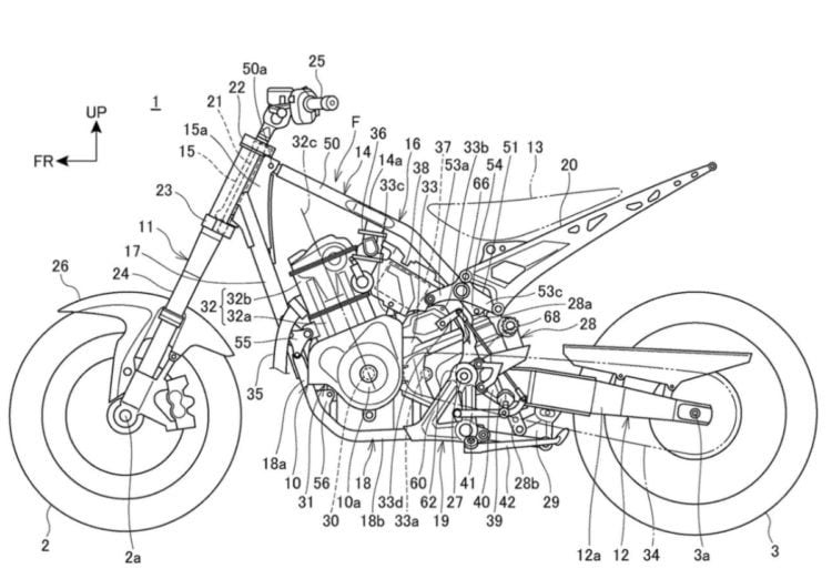

Honda Patent - Cradle Version
The cradle version with engine and running gear.
The drawings show both frame designs with identical swingarms, upside-down forks, handlebar position, and seat position. Steering geometry and wheelbase are also shared between the two. Whether the drawings show two different models to be released, or two designs competing with each other to see which reaches production, is unclear.
