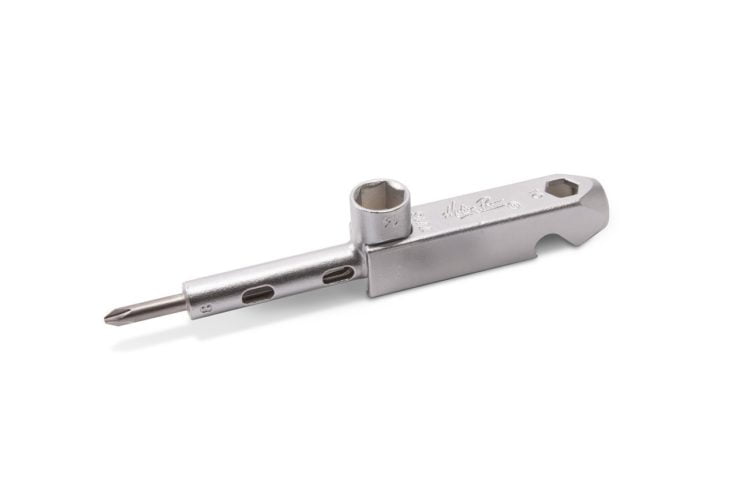

Trouble is, most aftermarket toolkits are bulky, and so are most home-assembled kits. What do you do, if you want something small and lightweight? That’s where the ultra-compact MP Tool comes in, from Motion Pro. It’s tiny, but this well-designed multi-tool is surprisingly versatile.
The MP Tool doesn’t come with many pieces, but it can do a lot of basic tasks. Photo: Cycle Gear

The MP Tool is based around three main parts: a square handle, an L-shaped mini cheater handle, and a double-ended driver. The handle has two crude-but-effective 10mm wrench openings, a 12mm wrench opening, and a 7/16-inch opening. There’s also a built-in bottle opener. That isn’t a necessity for motorcycle repair (it may even contribute to motorcycle disrepair!), but at least if you need an opener in a pinch in the middle of Baja, you’ve got one.
The driver is reversible, and fits into the 12mm hole on the end of the square handle. This configuration allows you to use it as a 1/4-inch driver. Rubber O-rings on the driver keep it from wiggling inside the handle.

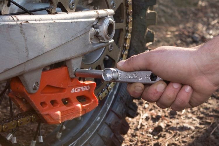

Use the L-shaped handle to fit into the square handle, so you have more torque. Photo: Motion Pro
Wait–you say you want more torque? That’s where the third main part comes in, the L-shaped cheater handle. This cleverly slots into the other end of the square main handle, giving you much more torque. There’s also a 14mm shallow socket-type wrench on one end, and an 8mm deep socket-type wrench on the other end. The reversible driver also slots into this 8mm hole, allowing you to use the cheater handle as a 3/8-inch driver. Devilishly clever, wot?

If you want to quickly unscrew fittings, the L-shaped handle flips around, for applications requiring less torque. This is a very versatile design. Photo: Motion Pro

Don’t expect to use this for high-torque applications, but it’s great for smaller fasteners. Here, the wrencher is using the 8mm deep socket on the end of the L-shaped handle, but could also have slipped the double-ended driver in to use a 1/4-inch or 3/8-inch socket. Photo: Motion Pro

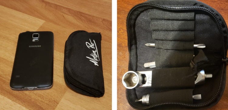

The carrying case is small; see it next to the cell phone, for comparison. Look inside, and you see you can pack it very tight, with room for several more fittings besides what comes as stock. Photo: Zac Kurylyk
