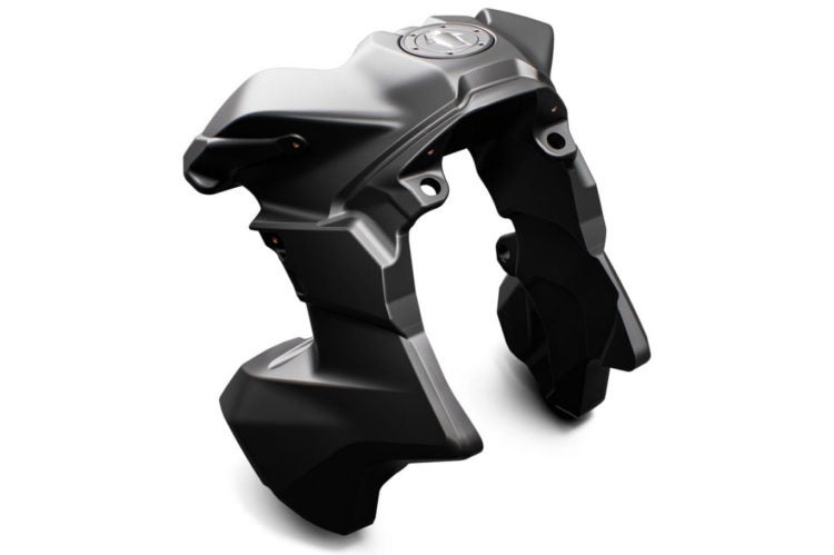

That’s a weird-looking fuel tank! However, its design works very well at centralizing weight, and KTM says it can take a beating without springing a leak. Photo: KTM

Nothing remarkable, until you get to the gas tank itself. KTM’s really gone out on a limb here, with a massive fuel tank that sits over the engine and frame like an upside-down U. The innovative design means most of the gas is held low, in front of your legs, in the position you’d normally see the cylinders of a BMW boxer.
It seems a bit sketchy, and when the first drawings and photos of this design hit the Internet, people thought it was crazy. However, KTM’s development riders swear they’ve been unable to destroy the tank in crashes, despite its low-slung design. At least it’s given a measure of safety from bolt-on plastic guards.
The fuel tank has 5.3 gallons capacity (20 litres), which KTM says is good for a maximum range of 450 km. If my math is right, that’s roughly 53 mpg for fuel economy, under ideal conditions.

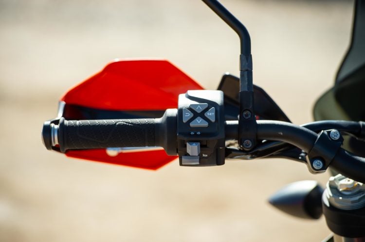

You make changes to the bike’s onboard electronics via the left-hand handlebar button cluster. It’s very simple, much easier than previous KTMs.
