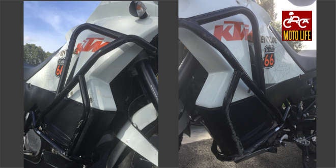

Here is the mighty KTM 990 Adventure with the Heed Crash Bars installed, including the HEED bags and the Wolfman Luggage Hoop Micro Saddle Bags on the crash bars for added storage.
HEED Crash Bars scuffed up after a few adventurous rides

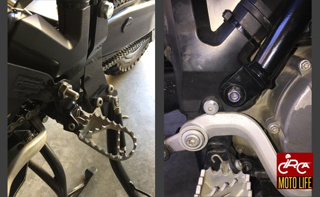

I did run into one fitment issue during our KTM 990 Adventure HEED Crash Bars installation as the 340mm cross bolt that goes through the lower engine case did not fit properly. The length and diameter of the bolt were fine, however the bolt was tapered into 3 sections of 10mm, 9mm and 8mm. Spacers were provided to fit at the 10mm side (left/gear lever side of the bike) and the 8mm side (right/brake lever side of the bike) of the bolt. The issue has to do with the length of the 9mm and 8mm tapered section as it resulted in forcing the 10mm side of the bolt to stick out way too much on the left side of the bike and barely enough on the right side. This caused having way too much of the bolt sticking out the left side that it interfered with my boot when trying to shift gears. On the other side, there was barely any thread sticking out of the bike to get the nut onto it.
HEED KTM 990 Crash Bar Fitment Isuue
Original cross bar sticking out 1/2″ on left side and not enough on the right side
I emailed HEED about this issue and their customer service was fantastic! They ended up shipping out a new cross bolt that did not have 9mm tapering in the middle, which resolved the problem. Much thanks to HEED for the quick response and resolution.
HEED Crash Bars Fitment Resolved
