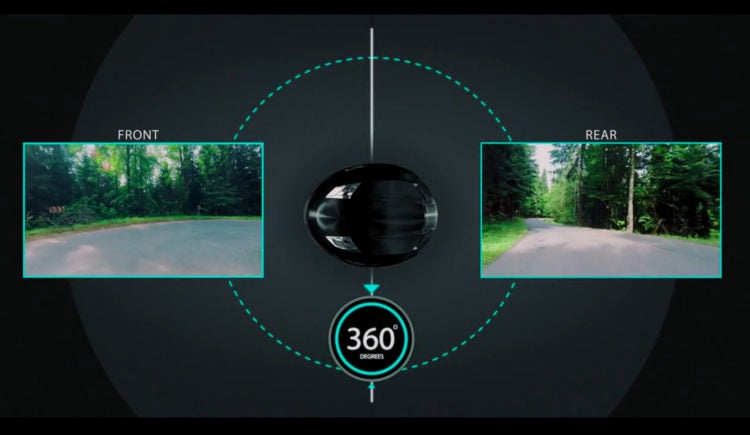

We’ve also written about futuristic helmets with Heads Up Displays, built-in front cameras, rear cameras, and a Bluetooth connection to your smartphone.
360 view on the X-AR — photo courtesy of JARVISH

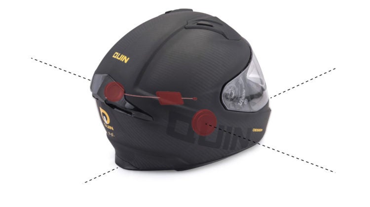

Sensor locations in the Quin helmet — image courtesy of Quin Design

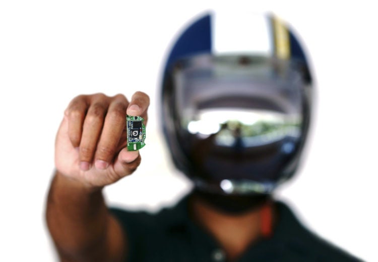

This doesn’t happen on its own, though. The helmet collects the accelerometer info via its custom built-in Quin Arc Chip. The chip then sends a message to your smartphone using Bluetooth. And yes, you need an app for that. It’s the appropriately named Quin app. You use it to list your contacts and settings.
Quin Arc Chip that’s in the Quin helmet — photo courtesy of Quin Design
