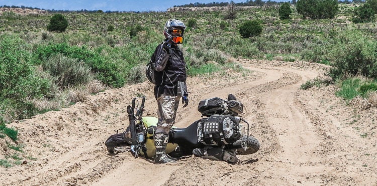

You go out and ride in the dirt, anything but pavement, be it graded roads, fire roads. logging tracks, single or double track, and you take a low-speed dirt nap.
There are lots of new riders to the dirt and the interwebs are awash with photos of proud owners standing next to their downed bike.
After going down in an easy off most likely your riding buddies will most likely get a photo of you
Yep me and my dropped bike in sand
Ok so next get the bike up, jump on and ride away, right?

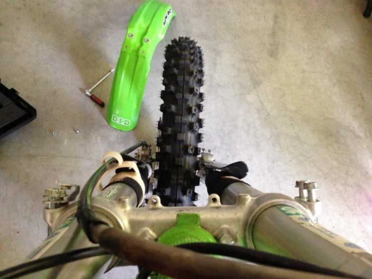

  1. are you bars aligned with your front wheel?
photo courtesy of thumper talk
This is the easiest thing to happen to your bike even on a minor impact or drop.
Quick and easy to resolve, loosen your pinch bolts, hold the front wheel straight between your knees then make bars line up correctly and square, then retighten the pinch bolts
