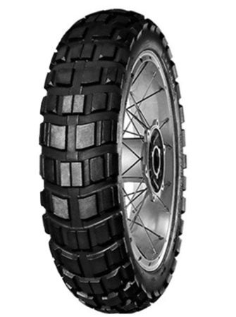

Anlas Capra X. Photo Credit: Anlas
Anlas Capra X
Recently I had the chance to try the now popular Anlas, the famous tyre made in Turkey. A lot has been said about the Capra X that, being a “pure” off road tyre, delivers optimal performances also on tarmac.
The thread, with knobs that cover the central part of the tyre, alternatively, provide a smooth ride, without too much vibrations, and almost a noiseless experience on tarmac. The vibrations increase once the tyre wears out a bit. Great grip also on dry and wet surfaces and, of course, excellent performances off road. I’ve been riding in snow and mud and I have to say that it behaves 90% like a dirt bike tyre.  Price wise it’s halfway between the expensive ones and the cheap ones. Longevity, obviously, is not its strength but If you are gentle with your throttle, you can stretch probably 6-7000km with it.
Tarmac Dry Grip: 8
Tarmac Wet Grip: 8
Off-road: 9
Longevity: 7
Price: 8
