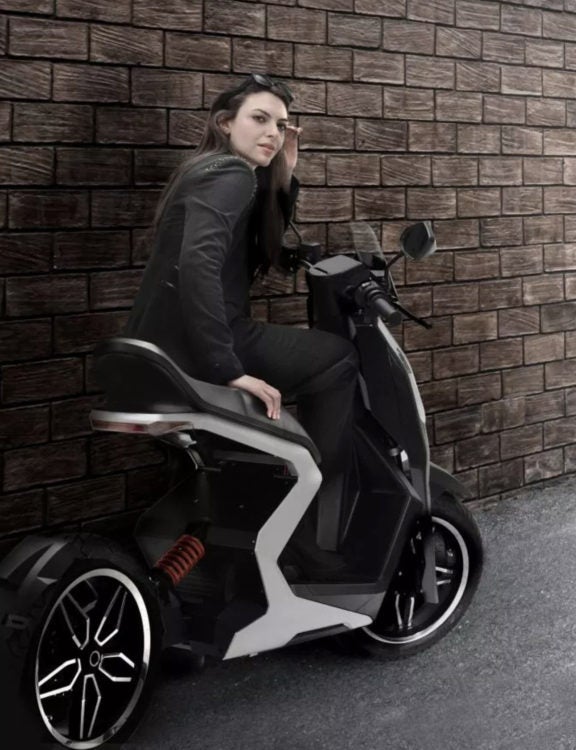

Zapp i300 scooter — photo courtesy of Zapp Scooters
Made in the UK and taking pre-orders right now, the Zapp is zippy. It can make 0-30 mph in 2.35 seconds, 0-45 mph in 4.1 seconds, and has a (governor-restricted) top speed of 60 mph. For a scooter, that’s seriously impressive.
The performance is thanks to a more powerful motor than you’d normally find in an electric moped. It’s rated at 18 hp instead of the 3-5 horsepower that’s more common.
It generates 587 Nm (433 ft-lbs) of torque, which is more than the (so far, vaporware) Curtiss Zeus, which is (or will be, someday, maybe) a full-blown cruiser. Zapp gets the torque via a two-stage belt reduction, which gears down the electric motor.
Energy comes from two 48v batteries each rated at 1.25 kWh.
