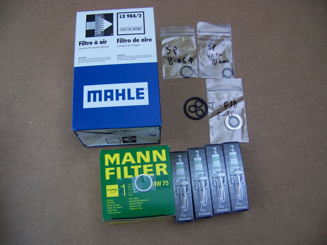

    According to what they posted, it's Mahle air-filter but MANN oil filter... :dunno
    [​IMG]
    I don't buy my consumables from BBY so not sure if this is out-dated picture or else... :hmmmmm
