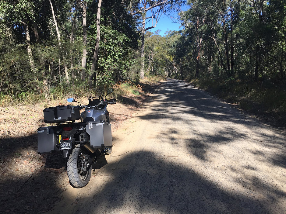

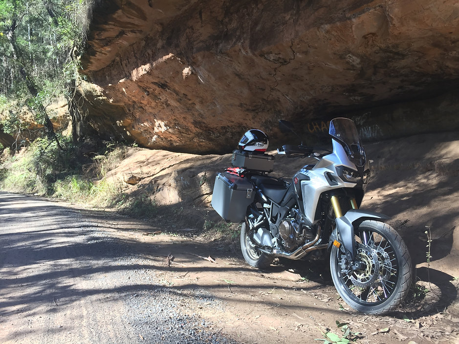

    20160921_161630_resized_1.jpg 20160921_161718_resized_1.jpg 20160922_104514_resized.jpg 20160921_162419_resized_1.jpg
