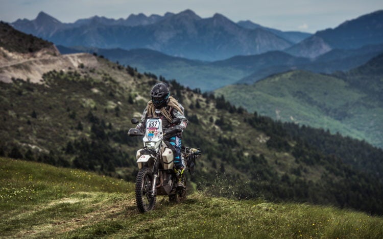

Lucy, my trusty Suzuki DR650, has been through some stuff. Having bought it second-hand in Arizona three years ago, I then took it across the Americas and Europe and completed Hellas Rally 2019 and Bosnia Rally training event that same year; this year, I’m hoping to finish another Hellas Rally and, if I don’t completely destroy the bike, my bones, and my budget in the process, do the Iberian Rally in Portugal in the fall before continuing my solo journey to Africa, Corona-allowing.
Right off the bat, Lucy was no stock bike. Having been set up by none other than @rtwpaul, my DR650 already sported a whole bunch of mods from Warp9 wheels, levers, and pegs to a steering damper, a larger tank, and a custom Seat Concepts seat among others. Being a self-proclaimed dyslexic when it came to all things mechanical, I’d never dreamed I’d begin getting into bike builds and mods myself, but trying to transition from adventure riding to cross-country rally racing, I simply have no other choice.
If you’ve got the means, the easiest thing to do is either buy a proper rally bike like a KTM450 or do a rally build with the pros, like Stefan Hessler who is an expert at transforming Suzukis into rally beasts. When your means are below modest, however, you’ve got to do it yourself, get as much help as you can, and modify little by little.
Photo by Actiongraphers | www.actiongraphers.com
Lucy is far from finished when it comes to my dream rally build; and, even with the best mods, it’s never going to be a true rally machine. But I’ve got to work with what I have, and besides, Lucy and I are still on the road between the races, so it still needs to function as a pack mule most of the time.
