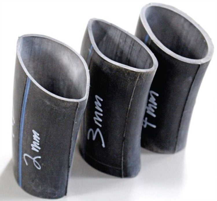

Tubes: This is the simplest and oldest variant on the market and is basically a rubber tube that fits inside the tyre and holds air pressure.
Tubes: Various Thicknesses available from under 1mm to 7mm these days.
Tubes: Various thicknesses available from under 1 mm to 7 mm these days.

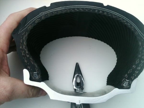

Tubeless: This is where the tyre and rim create the sealed volume for the air. Essentially the same as a tubed setup but without the tube. Most common on road bikes and big adventure bikes.
Tubeless Tyre Cross Section
Tubeless tyre cross section

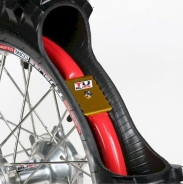

Tubliss: The last system I would like to mention is the Tubliss system. This is an inflated insert fitted within the bead area of the tyre allowing effectively a tubeless main tyre with a rim lock. More suited to small and mid-sized adventure bikes. Personally I didn’t have good success with this and don’t feel I have a need for it today but I like to mention the solution it offers.
Tubeliss: An inner inflatable tube to seal the tyre and effectively make it tubeless.

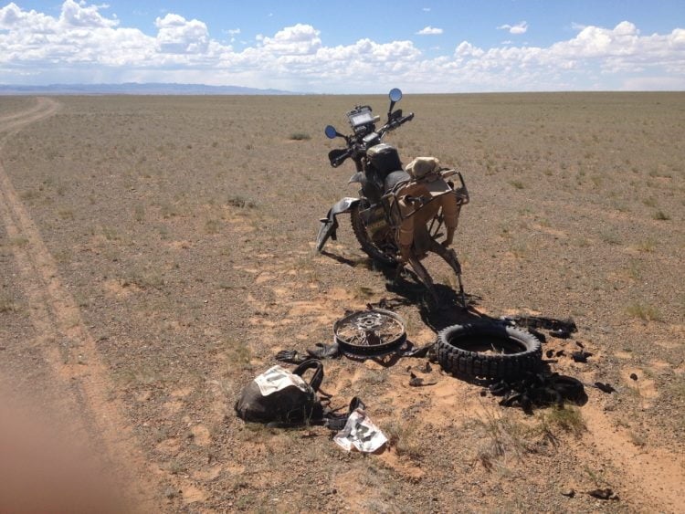

2014 – Rally Mongolia. I tired a Golden Tyre Mousse and it didn’t even make it 100km.
2014 – Rally Mongolia. I tried a Golden Tyre Mousse and it didn’t even make it 100 km.

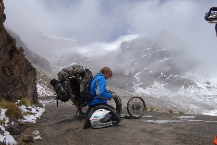

To summarise, on my long distance adventure rides covering weeks, months or years with all kinds of speeds and terrain involved, I still use tubes. I love to ride extreme tracks and trails on all my adventure bikes and I have damaged the tyre multiple times having to stitch the carcass (see image below from Peru). Also, I find it easy to remove a wheel and repair a tube and the small time it takes (if the technique you use is good) can be insignificant. I’d also like to add that while on Races to Places, five years travelling around the world on Basil Bike using tubes for 234,000 km (but for the last 8,000 km in the front) I only had a total of 31 punctures, that’s an average of one every 7,500 km. Personally I feel it’s totally acceptable to have to stop and remove a wheel to repair a puncture just once every 7,500 km of extreme adventure riding and tubed tyre setups are the cheapest and most readily available all over the world.
2016: Peru, South America 16000ft altitude stitching my damaged tyre.
2016: Peru, South America 16,000 ft altitude stitching my damaged tyre.
