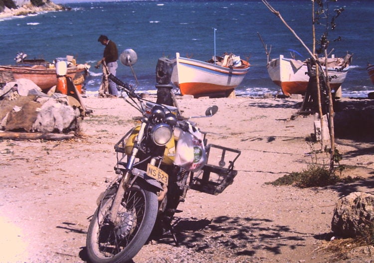

My bike with luggage removed looks odd, but you can see the welded-up cages.

We bought small-ish rectangular plastic panniers. Faced with the problem of mounting them securely to the bikes, we decided to solve several problems in one go. As well as fitting the panniers securely, we wanted some kind of crash protection. We also wanted to carry water and extra fuel. The solution was to have cages for the panniers made up from mild steel. A strap across the top locked them and locked them onto the cage. Smaller holders on the front of the pannier cages held four litre plastic reagent containers from a haematology analyser donated by an ex-girlfriend. One held water and the other additional fuel. They were secured with thin, swaged steel cables. The whole thing was locked with one padlock each.
The reagent containers weren’t the only donation we received. Charlie’s friends at university made up aluminium boxes which fitted neatly onto our Acerbis tanks. They locked with another padlock and had holes cut into the bottom which fitted over the fuel caps. That held them in place when the caps were screwed down. Their padlocks thus didn’t just lock them, they also locked the fuel fillers.
Our friendly welder made up lockable tool boxes for us, as well, which tucked into the sides of the bikes below the seats. All up, then, each bike had four padlocks which secured all our storage.
