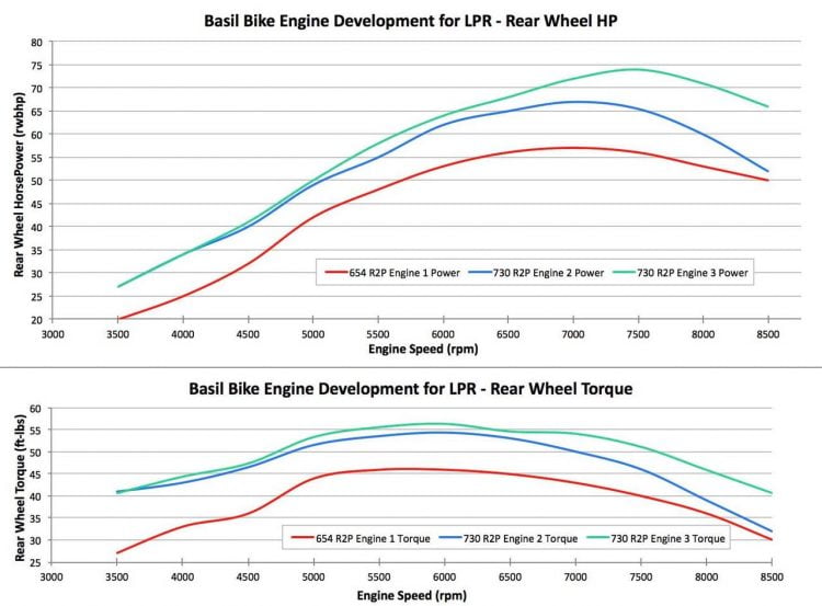

In Australia November 2015 I needed to install new piston rings in my bike after 75,000km of hard riding because of oil consumption was high. I opted to increase the size of the engine with the LPR 732cc kit (bore and stroke) and an LPR high lift camshaft. I also installed the Nova Racing wide ratio gearbox which has a lower 1st gear for technical situations and starting and a higher 6th than any production gearboxes meaning I can cruise at higher speeds with lower revs and get better fuel economy. My engines also run lower compression compared to that of the production models, which allows me to run much poorer quality fuel grades. Occasionally, 80 grade is the best you can get in some of the places I choose to ride. The 732 kit with camshaft, modified combustion chamber and ported head made a big difference and has now been in the bike for over 120,000km, along with the Nova gearbox. Tried and tested, more power and torque, more fun to ride and easier to ride in all situations thanks to the truly ‘adventure ready’ gearbox. Big smiles all around.
Credit: Lyndon Poskitt
I completely rebuilt the engine in Cape Town, South Africa in July 2018 and fitted a new type LPR piston and rings, a newly developed camshaft to maintain more torque and mid-range and some inlet tract modifications to increase top-end performance. This is the motor I will race within Africa and ride all the way back to England. I also now have a completely new LPR clutch setup for this bike to deal with the additional power and torque it delivers. The Adler was no longer strong enough. The new setup is also available on the website. The complete engine builds and parts available here.
Dyno graph of all 3 motors specs
Dyno graph of all 3 motors specs, supplied by Lyndon Poskitt.
