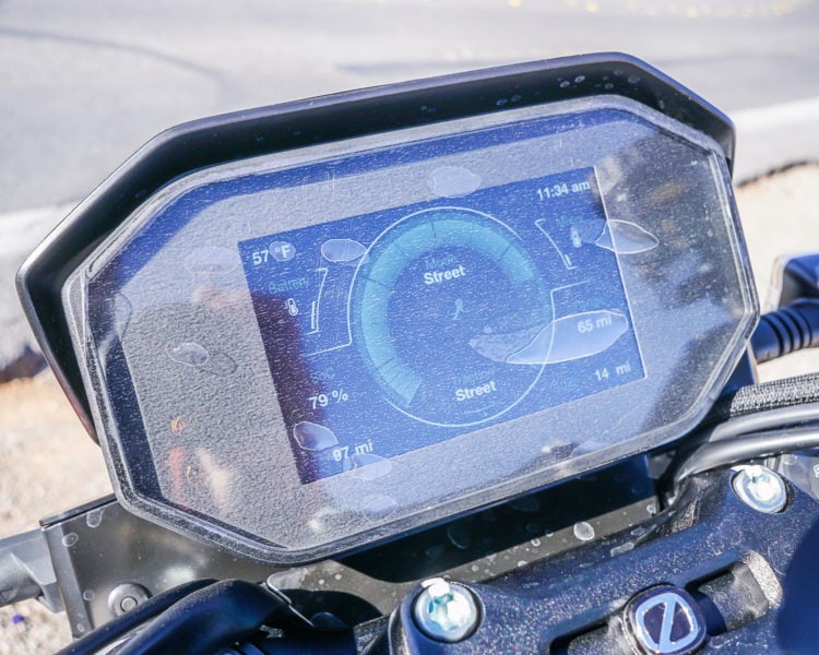

The control panel between the bars was clear and concise, easy to read (it has delivery plastic on the screen BTW, to be removed by the buyer) and understand while riding, showing you all the information you need and nothing more. It can be adjusted to suit your needs and hidden in the menus was a full array of options to play with.
image – rtwPaul
(Screen has a removable plastic cover to stop scratches, still attached)
